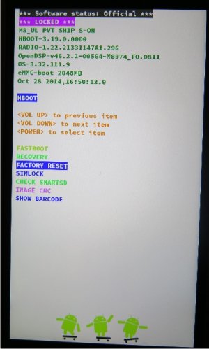

By the time she emailed me to tell me her phone no longer worked, she had tried several things such as Recovery and Factory reset, etc. If the phone is put into Recovery mode (from the Bootloader screen – the one with three android figures at the bottom) it just cycles non stop from the red triangle to white screens and back to the red triangle and the only thing you can do to then phone is press Volume up and Power button to get the “Android System Recovery” screen. I have tried to execute all five of commands on that screen – “apply from sd card”, “apply from phone storage” … “wipe cache partition” but the end result is always the same – just an endless red triangle to white screen non stop until the battery dies.

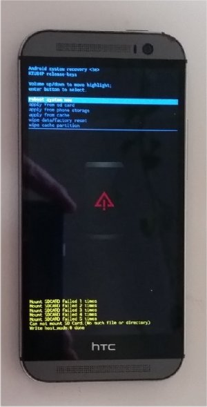

On the Android system Recovery screen, there is a consistent error message “Mount SDCARD failed 1 times” (and then … failed 2/3/4/5 times), followed by “Can not mount SD Card (No such file or directory). So, to recap, anything I try to do from the Bootloader screen leads to the Red Triangle/white screen cycling which can be interrupted ONLY by Volume Up/Power buttons (not by Volume Down/Power buttons) which gives the Android System Recovery screen and all of those options also lead to the Red Triangle/White screen loop. Also, and probably very importantly, it doesn’t seem that my computer can “see” the HTC when plugged in .. at least it doesn’t show up in the traditional way it used to when plugged in via USB cable.

The second picture with all the failed attempts should be normal if you don't have an external SD card in. Mine gave me that all the time.
When it is done scanning for the SD card, can you do anything in recovery then? Reset and power button to accept?

Nothing works. I try "wipe data/factory reset" and the same cycle continues - the bright white screen flashes two or three times and then after a minute or two the red triangle shows up. about a minute or two later, it goes to the white screen/red triangle cycle again .. and can continue all night (as I've let it twice to run down the battery). I cannot power off the phone using the power button. I can only access Volume up+Power button to get back to the Android system Recovery Screen. the only way, in fact, I can even get to the Bootloader screen is when the battery has been completely drained and I then turn on the phone with volume Down+Power buttons.
