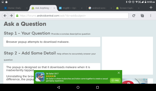

I have some sort of infection on my Android device as shown on my screenshot above.
I have installed Malwarebytes but the scans tell me that the device is clean.
The green popups purport to download and install legitimate apps but if they are inadvertently tapped, they download malware.
The popups only appear in the various browsers. Ie. if I install Chrome, then they activate in Chrome and if I uninstall Chrome and install Firefox, then they appear in Firefox.

No, the screenshot shows the popup on this website.
Edit:- Sorry, wrong screenshot uploaded.Screenshot_2017-07-12-08-50-52.png

The popups appear on all sites.
It will appear on androidcentral.com and it will appear on bbc.com, blender.org and others and it always takes the same form which is the green horizontal banner as in the screenshots above, so I doubt it has anything to do with the sites. Something has installed itself on my device.
