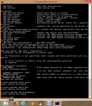

Screenshot (10).pngScreenshot (9).pngbut my device was not found by adb devices in recovery mode, it is the problem for adb push?
I want to fix this softbricked phone. The phone works in adb sideload mode, the file can be sent into the phone. The only problem is it says "Installation aborted" whatever I tried to apply from ADB. Any suggestion?
