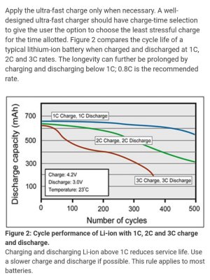

The recommended C rate is around 0.8 for best longevity, and accelerated wear really kicks in over 1C. My V60 charger is capable of 1C max, which I don't use. Everyone was so excited about the Samsung (funny side note, my autocorrect tried to replace Samsung with "damaging") 45W charger for the N10+ but that is just over 2C at full speed. Yes, the C rate is based on battery size, but manufacturers are already cutting it too close for comfort. The screenshot of that relevant info is at https://batteryuniversity.com/index.php/learn/article/ultra_fast_chargersScreenshots_2020-07-16-23-05-16.jpeg
