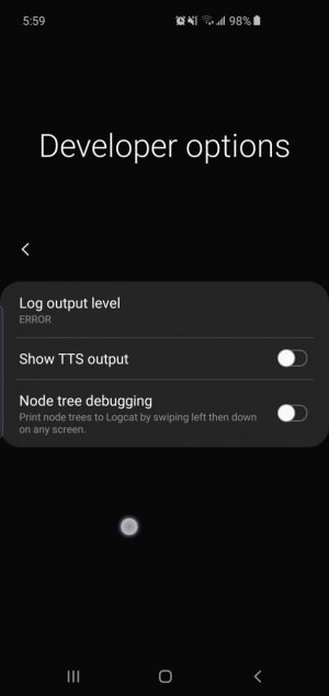

That's all you have for developer options? Definitely seems like the show taps option. When I enable it, it looks just like your screen shot

What do you have if you press the back are on that screen?

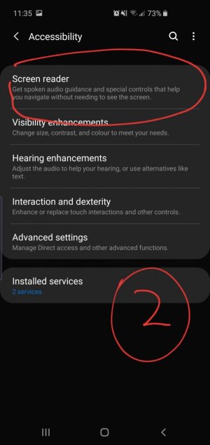

Yes, that is a submenu.
Back out to the Settings, scroll down to the bottom and select Developer Options. Untoggle the selection I have circled.

Erm your developer options seems wrong...
Go to this page.
Honestly that is all I have for my developer options

Looks like this is the difference.
OP was looking in Settings -> Accessibility -> Screen reader -> Settings which also has a "Developer options".
