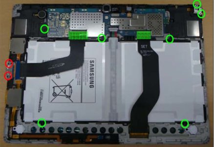

If motherboard is needed, you can buy a tablet with broken screen ( around $100 ) and swap the motherboard. Samsung tablet is quite simple as there are only 3 screws at 2 speakers to hold down the mainboard. It takes me only 5 to 10 minutes to remove the motherboard.
That's great info about the motherboard. Is there some info on how to take the tablet apart..???
