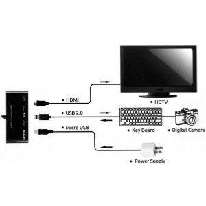

You need to unlock the device to see it
Use a micro usb to usb cable to plug in a keyboard and type the keylock code
Or get a MHL cable to plug in a hdmi to see the screen

After I plug in the HDMI cable how am I going to be able to to unlock the screen if it's a pattern code? does the HDMI only transmit the image or can I control my phone remotely from the computer/TV I plug it into?

Connect an USB OTG to your phone, connect an USB mouse into the USB OTG. Use your mouse to unlock the pattern! (Problem is, This only works if you can still see the screen) If only there were a program out there to allow your tv or (in my case) touchscreen monitor to act as the smartphone led. So you can still see the contents on your from via your tv or monitor!
Here's what it looks like

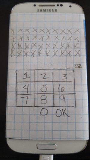

My phone was locked with a PIN and I used graph paper to map out the keypad (I had touch screen sounds enabled so I was able to determine where the screen was responding to my touches). My graph is attached - you may be able to map this on your phone based on the grid. If not, what I did was:
1. Turn off phone
2. Tape graph paper across screen making sure not to cover the speaker in the back.
3. Touched the screen in each square of the grid and marked where I heard a sound. I noticed that the keypad produced a sound on the first touch where other notifications, widgets, etc. required two touches.
4. Using the markings, I built out the keypad.
5. Restart phone, enter PIN and your phone should be unlocked.
Once unlocked, I took a screen shot of my phone because I saw I had notifications I wanted to check.
Not high tech, doesn't require buying USB mouse converter or other equipment.
Hope this helps!
