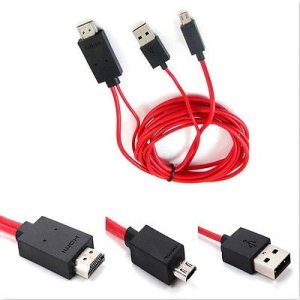

If your phone doesn’t have a micro HDMI port but supports MHL to HDMI adapters, then you’ll need to purchase a special OTG plus HDMI adapter. You might be able to find it at your local phone store. One great adapter is available on Amazon for about $19.99. This particular adapter supports five different connections and you can connect your HDMI cable and a USB mouse directly into this adapter.
otg hdmi adapter

Connect the USB mouse into the OTG adapter and plug in the HDMI cable into the OTG adapter as well. If you have a micro USB HDMI port on your phone, then connect the micro HDMI cable into your phone. Connect the other end of the HDMI cable to your TV. Turn on your TV and switch to HDMI mode.
hdmi otg connection
Step 5
You should now see your phone’s display on your TV. You should also see a mouse pointer on the display. Use the mouse to draw the unlock pattern on your phone or click on the keys to type in your password. That’s it! You have successfully unlocked your Android phone.:)

Had this just happen to me, I hooked my phone up to the TV with a $6 cable and was able to see my screen on the tv. Punched in my pass code (took a couple tries) then downloaded smart switch. Downloaded smart switch on new phone and sent all data from old phone to new phone while the old one was still hooked to TV. Worked like a charm..
