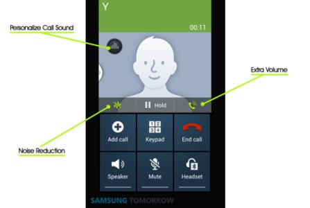

but when i switch to loud speaker people are not able to hear me when i enable noise reduction its working fine

-People can hear you on speakerphone when noise reduction is on (am I understanding this part correctly? And where is the noise reduction setting?)
