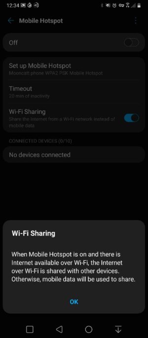

On my LG phone, the hotspot setup screen has an option to share Wi-Fi. I have no clue why you'd want to use it (maybe a makeshift network extender?), but it's there.Screenshot_20220117-123420.jpg
