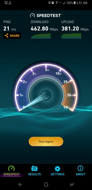

I use mine at home (single one) without issue. It powers all my devices like it should. The devices that can use the 5ghz network get it and benefit from the speed of my ISP.
My one wired device (my PC) gets the full benefit of my ISP (940 Mbps down / up).
