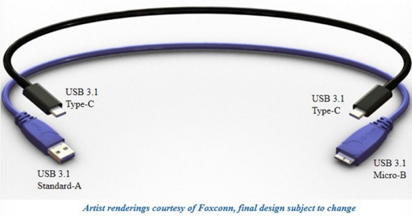

There is a consortium that decides the standard plug style for charging mobile devices. Participation is voluntary (though I believe there are some countries that are now requiring use of the standard, though I think Apple has managed to get around this with adapters or something so far), but most major manufacturers have decided to participate. The current standard is Micro USB. I believe I've read that they've already decided that the next standard will be USB 3.1 Type C, but they are still finalizing the design. It will be smaller than the USB 3 on the Note 3, and reversible.
Upcoming Reversible USB Cable Depicted in New Renderings - Mac Rumors
