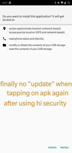

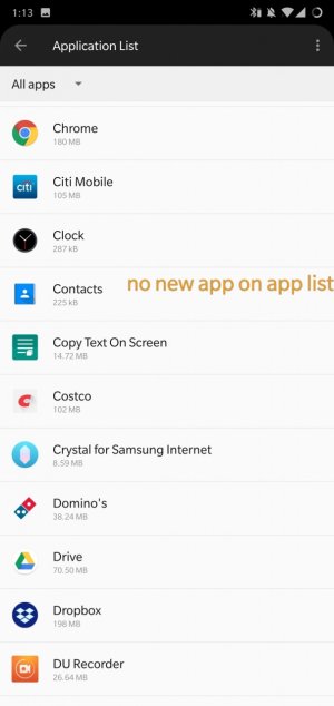

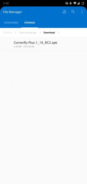

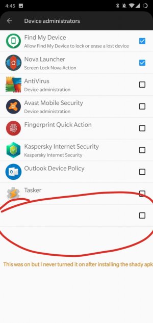

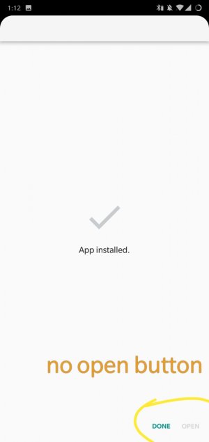

So I was looking for an app to make the top radius match the bottom radius on the corners while using the option of hiding the notch. Someone suggested a very shady link to download an apk but since I'm desperate and dumb I just downloaded and installed it. However, after installation there was only a "done" button but "open" button was greyed out, there was no new app on app drawer and there was no new app in application list in settings. I started getting worried that I had just installed some bitcoin mining software or another kind of malware.

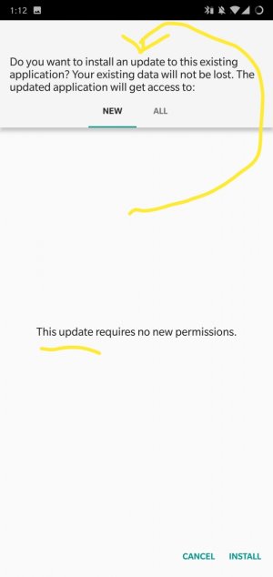

I got even more worried because if I tapped on the apk again it was asking me if I wanted to UPDATE the app instead of if I wanted to install it so it was already installed and it had permissions to access gps, phone history, and read, modify and delete USB storage.

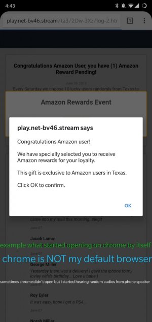

After a while during the day, my phone started doing random noises from the speakers like audio from ads but without opening any app, then later it started opening random chit on google chrome and that is not even my default browser (my default is samsung browser), it opened those very intrusive ads that tell you you have a virus and you cannot go back you have to close the whole tab or app it also opened some ads with sexual content a few times.

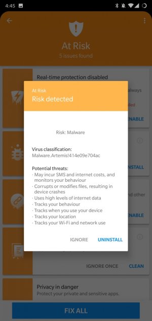

I always thought all free anti-virus app on the play store were completely useless and just bloating apps but I started installing a bunch, most didn't detect absolutely anything after the option "scan all apps" I tried kaspersky, avast, AVG, Norton, etc. then I installed this (it's called "hi security" so not known brand and I thought it was going to be the worse but after opening it was powered by "McAfee" so at least McAfee is known):
https://play.google.com/store/apps/details?id=com.ehawk.antivirus.applock.wifi
And it actually detected some malware after scanning all apps, there was an app with completely blank name on device administrators that I never gave permission to become device administrator as far as I remember, so I unchecked that app from admin and then the antivirus app was able to uninstall it.
After the virus cleaner uninstalled the app I haven't had any more issues with audios or ads opening on chrome. Do you think I'm safe now or could I still have some spyware?

damn on the S9+ it was even weirder, when I tried to install it it just freezes, I tried several times and freezes everytime on "installing" so no buttons of "done" and "open". But after the first time if it tells me again if I want to "update" app so it was already installed. I went to device administrator and there it was at the bottom of the list just an app with no name and on applications list I was able to find two, one called "settings panel" wtih a generic gear icon and no permissions, I uninstalled that one, and at the very bottom of the list there was another one with no icon and no name and the permissions of calls, gps and storaged activated. I went to "Hi Security" app and it detected there was malware code and asked me to uninstalled but I didn't and switched to Malwarebytes app, the malwarebytes took a while doing the deep scan but it did find "two infections". The installed infection and it was also encouraging me to delete the APK. I was using the 30 days free trial so I'm not sure if the free version would have found them without the "deep scan".
I ran malwarebytes on the OP6 (without installing the infected app again) and it didn't find any infection. It seems that malware was from "adware.mobidash.NC"
