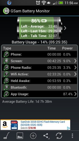

Not sure how awesome my battery life really is but it seems to get me through a day no problem. What do you guys think? Any advice on saving more battery? GPS and all of that is turned off. Sleep mode is enabled after the phone has been off for a while. Both WiFi and Data. Any advice is welcome! (Battery guru is also on in the background.)
