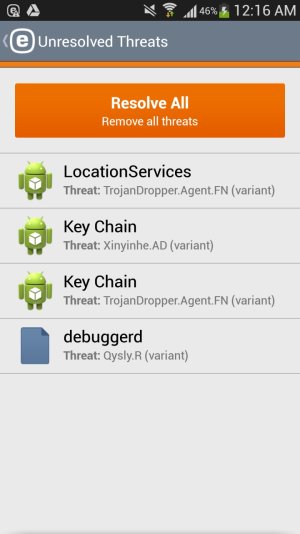

After that, I was able to delete most of the ghost push malware installed on the phone using the app Stubborn Trojan Killer.

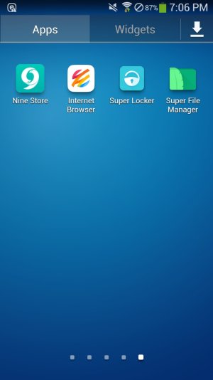

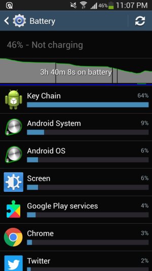

For months I have used it with 2 irremovable adware apps but my phone gets slower, more glitchy and the battery drains faster day by day. Since yesterday, the process System UI crashes every 5 minutes or every time I hold down the home bottom. All of that is driving me insane.

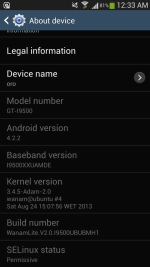

Also, this phone was from my best friend who rooted it so my question is: will flashing the firmware and installing another version of android repair the damage?

These are the trojan and adware apps:

I already made a factory reset and everything was gone but the apps stayed. I suppose I need to flash the firmware so can you tell which is best current rom for the GT-i9500?
