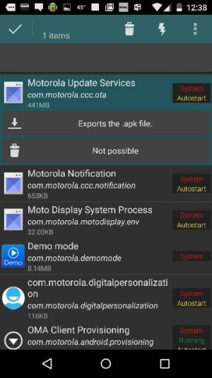

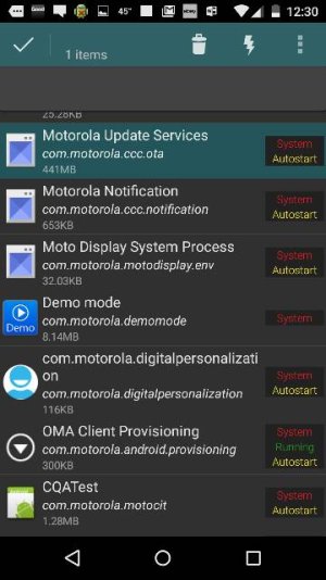

Do we need to buy the SD Maid for this freezing feature ?
Coz.... I am unable to find this option.
When i am tapping on Motorola Update service, i m getting the options to
Export
Kill
Share
Blah blah
But i m not getting freeze option.
Can u pls guide me?

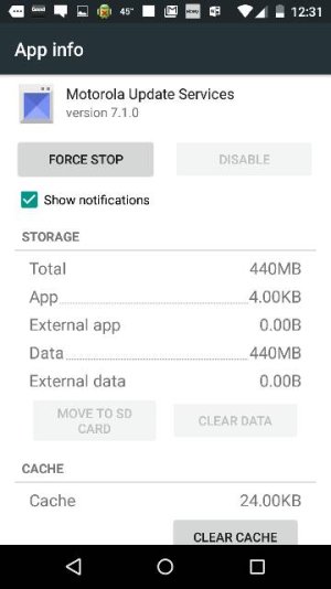

On Lollipop, the process you want to disable is called "Motorola Update Services." On your phone's app settings, 'Disable' is probably greyed out. So ... download and install a free app called SD Maid. In SD Maid, go into Settings.. AppControl... and check the box that says "Include System-Apps." Now, get out of 'Settings' and go into SD Maid's AppControl section and scroll down or search til you find Motorola Update Services (system name: com.motorola.ccc.ota). Click on it and choose "Freeze app." Save and exit.
You will now see on your phone's Settings... Apps.. that the Update service is listed under "Disabled."
