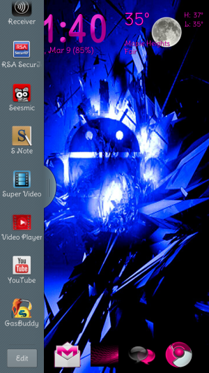

Sounds like you both are having the same problem.
The apps should automatically show in the multi window dock, I only had one successfully edited that did not show up.
I wonder if there was an update that is affecting the procedure.
My old gas buddy worked.
