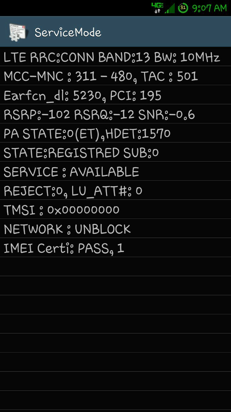

Must not be able to turn it off. I followed process, turned it off, restarted phone. Checked and it is still on.
This is what it says when I check the status when I use the code provided by OP. If I go thru the secret menu process again after restarting the phone, B4 is checked active again. Seems restart reactivates B4.
Sent from my SM-N900V using Tapatalk
