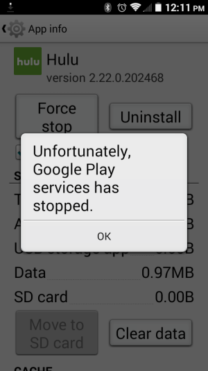

Hello,
I have a 2012 Nexus 7 (unrooted, running stock android). Until about a week ago everything was fine, but then errors started popping up. In particular I would be told that some app had stopped working and also receive other error messages saying that "unfortunately google play services has stopped"; this latter error began popping up more and more. After some googling I found that this was a somewhat common problem (or common enough to have multiple threads for different devices here and elsewhere online) and some potential means for resolving them. Unfortunately, nothing I tried succeeded in stopping this problem (i.e. rebooting the device; rebooting the device and clearing the cache via system recovery; clearing the cache and data from google play). I finally did a factory reset on the device. When it finished and I started the device up again and was prompted to sign into my account I was immediately hit with warnings that Google Drive, Email, and Gmail services had stopped. I sign in and I start getting the google service error again. Google Chrome also fails to work at all now (prior to the reset it would work, now it starts up and almost immediately shuts down; gmail also does not work, although google maps does).
I have also tried shutting off Google Sync on my account (since the reset) as another thread suggested that might be the problem, but shutting it off does not help ...although something does appear to be wrong with sync - when I go to my google account it says "sync error" under my account name and the message "sync is currently experiencing problems. it will be back shortly" is provided at the bottom of the screen. Clicking on the account I see all the services that are supposed to sync; currently they are all checked and everything appears to be synced, i.e. they all say 'last synced' with a period of a few minutes ago, with the sole exception of "people details" where there is an error symbol. Unchecking people details does not resolve the issue. that google sync may nevertheless be at issue is also suggested by a threat on justanswer that I found on this problem where someone with the same error posted about it someone suggests that it is likely a google server issue with the solution being to get google to shift the account to a new server. (this may be particularly relevant since I did recently move overseas, although this problem only emerged several weeks after that)...but I do not know how to check that or resolve such an issue if it were the problem.
I also an android based phone , but the problem has not really shown up there (although I did notice the same google service error the other day, it appears to have been an isolated issue).
Does anybody have any insight into how this issue can be resolved?

Hi,
I had the same problem , i tried to use old backups and restored the phone but didn't help.
So I tried to disable location services and then problem gone.
I think the location services is working like a timer getting the current location every second or so and probably cause the popup saying "google pay..."
For me disabling location services fixed the problem.
Setting > Location > Off
This worked for me (Asus TF700T) and is reproducible. Switch off LOC and the nagging messages stop. Switch LOC back on and they restart. Switch off LOC and they stop. And so forth.

So now the question is how to use my tablet if these nagging messages come up every time the Location is switched on, i.e. the Location function has effectively been torpedoed. A partial (but unsatisfactory) solution is to change the Location mode. My device offers three location mode options:
- High accuracy (uses GPS, Wi-Fi and mobile networks to determine location)
- Battery saving (uses Wi-Fi and mobile networks to determine location)
- Device only (uses GPS to determine location)
If I set the Location mode to "Device only" (the only mode my device can use because it is not equipped to connect with a mobile network) and switch Location to ON I don't get the nagging "Unfortunately, Google Play Services has stopped" messages.
UPDATE: I'm one step further thanks to the posting of ZubairAnwarKhan (posting #73 in this thread). He wrote:
Tip 2: Reset app preferences:
For this re-open: Menu --> Settings --> Applications --> Application Manager --> tab "All"
Now tap at the top right on "More" and then in the small menu on the "Reset app preferences". Finished!
When I did that I was able to change the Location mode back to High Accuracy without provoking the nagging "Unfortunately, Google Play Services has stopped" messages.

Friends, I rooted my Moto E xt 1022 & the problem started. I tried different solutions suggested in the post, but could not fix. I also restored factory set up. Finally, I uninstalled update for 'Android system webview' & rebooted the phone. From then the phone is working smooth.
One reason why Play services may crash is missing app permissions. This is probably mostly present in custom roms. My ASOP had blocked all request by Play services by default, but you can fix these in the settings -> apps -> Play services -> permissions.
This was TOTALLY the issue. I've spent countless hours trying to find a fix and sure enough it was only enabled for location and crashed on everything else. Thank you thank you thank you!
I fixed this problem by going into > manage apps , select the app, (Maps in my case) and then select Uninstall updates. I also turned off auto update. This is the second phone, of this model, that I have used this method on. Kyocera
