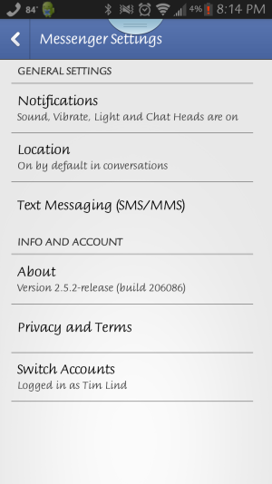

I have the option on my Sprint S3 for SMS integration, what I'm noticing is my version number is 2.5.2, maybe you need to update your Facebook Messenger?Screenshot_2013-05-17-20-14-33.png
I'm not rooted, stock Sprint ROM 4.1.2 MD4.
I have no problem getting it to work on my stock Note 2. Hit text sms/mms in the menu, brings up a check box. Have the same build as the post above me.
