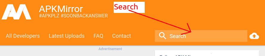

Using your device, browse to the above link and search for the two above-mentioned packages:

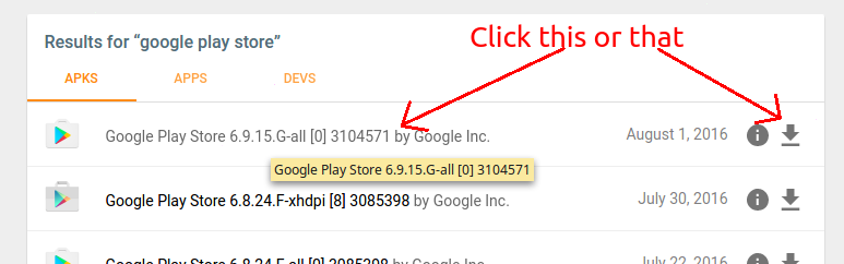

Select which version you wish to download:

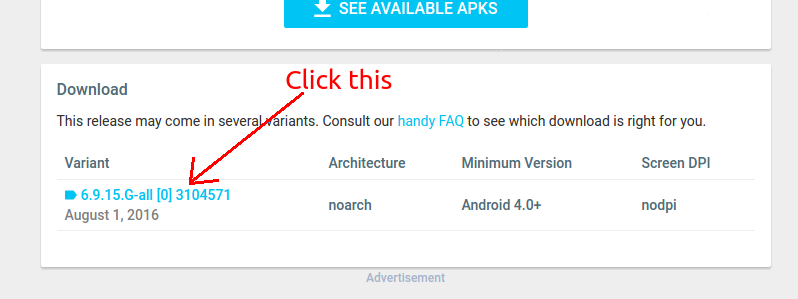

Click the file link:

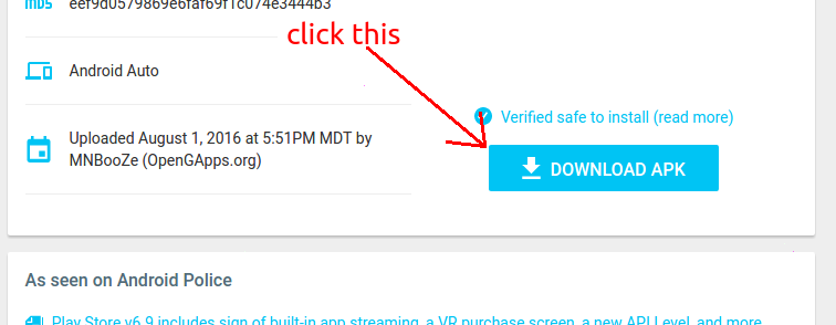

Click the download apk link:
