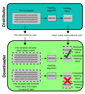

See the attached image, any single bit of information will result in an invalid hash, and that's only for the download verification, there are other methods implemented on the device itself to reject the file even if you get the whole file to pass MD5 checksum with a different hash.
As stated above: you cannot modify stock firmware and still have it work.
