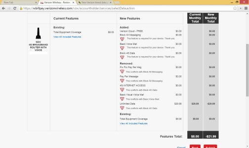

1. Take out an active microsim out of a Verizon 4GLTE smartphone on the legacy family share plan or individual plan and place it into the Verizon BRV. Go to your MyVerizon on a desktop browser and make any change (I added Verizon cloud service, but any feature change should work. This should automatically add the block 4G data feature. Submit the change, effective today.
2. Take the microsim out of the BRV and put it back into the 4GLTE smartphone. You now have a smartphone without a data plan.

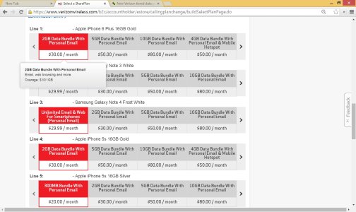

3. If you want to restore data (including Unlimited Data, if you have it), make sure you have the smartphone on the line. Go to My Verizon, and you will see no data plan selected for that line. Add unlimited data (or whatever data you have)

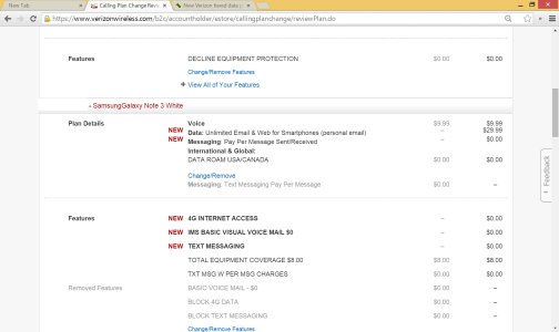

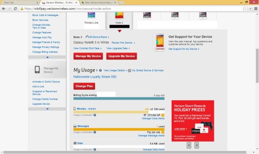

so do all data plans (including unlimited) show up as an option if you didn't have it before?
I am guessing that UDP only shows if you had UDP before blocking data

What happens when you tried to use data on the phone? Was it automatically blocked?
I ask because I have a dumbphone for my niece. I am tempted to try this and give her a smartphone.
Yes it was blocked. I couldn't get data until I reinstated unlimited data
