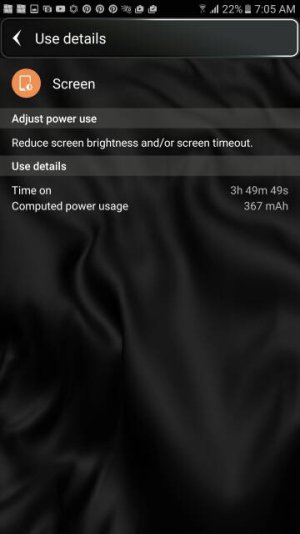

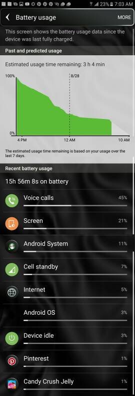

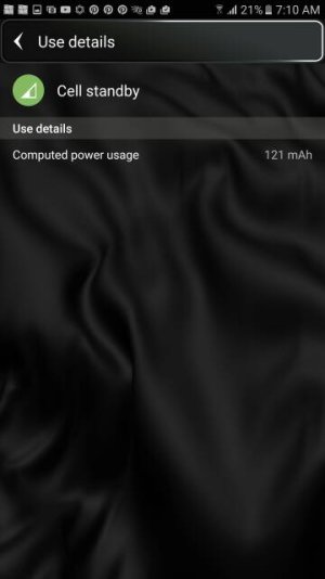

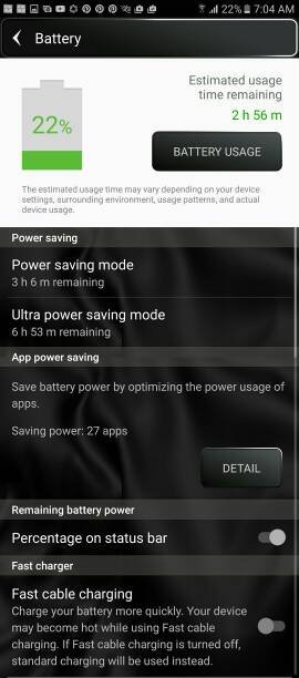

Here are the requested screenshots. Yhe battery life seems to have improve after making some changes. Yesterday was the first day I really saw improvement w battery life.
