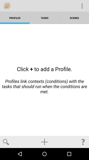

First off, open Tasker. You will see a couple starting screens. You can read them over and click the check icon at the top.

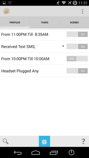

Once open, you will see a screen that looks like this:

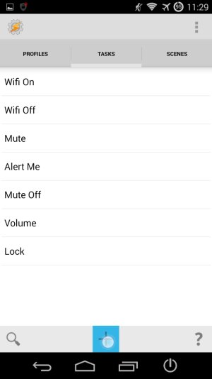

Tasker always opens on the Profile screen. For the next few steps, we need to be one screen over to the Action screen. You may swipe or tap the tab to get there.

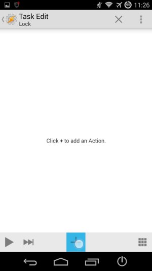

To begin, you will want to tap the '+' icon at the bottom.

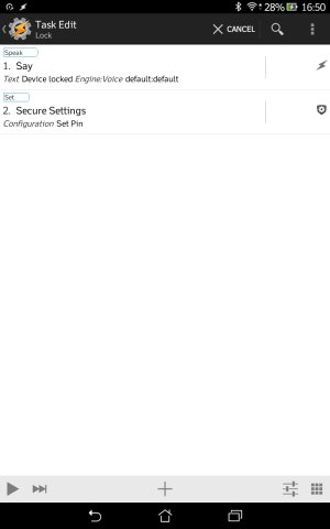

You can then name the task whatever you would like. In this case, I chose the title 'Lock'
(I already had this set up, but I made a screen shot to show what it would look like).
Tap the check icon to finalize the name. It can be edited later.

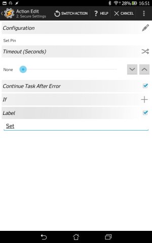

Next, we need to add an action. To do so, we will click the '+' icon at the bottom:

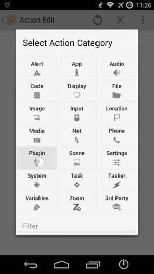

We then need to tell Tasker how we want this set up:
Selecting the plug in option brings the next screen up.

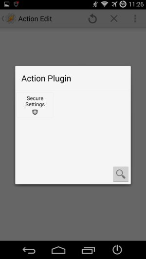

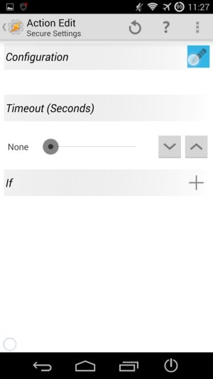

This is where Secure Settings comes into play:
And click on Secure Settings.
Clicking the edit button...
That button will take us to the next screen.

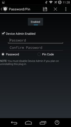

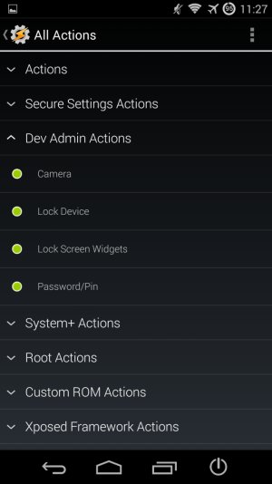

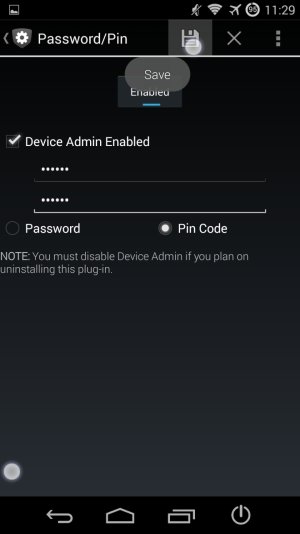

Choose Device Administration Actions, and select Password/PIN

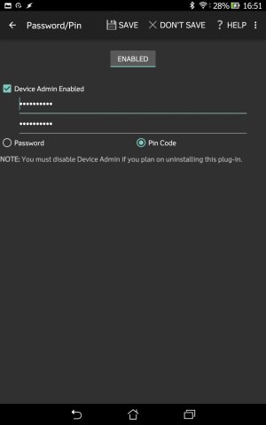

And follow to the next screen. Click Enabled.
This is where either a password or PIN can be entered. For a PIN, tap the bullet and enter your desired PIN.
There is the classic entry and confirm lines.
Once done, click Save, and you will be brought back to the Action Edit screen a few panels back.
At this point, you should be able to click back, and everything is saved.

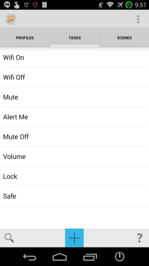

Now we need to do the same thing as a separate task but for when there is a connection to WiFi.

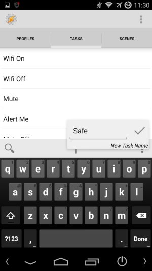

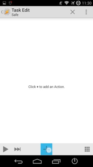

Starting all over again, we will make a new task:
And I called this one 'Safe'.
Click the check icon to save the name:

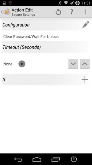

Click to add an action:

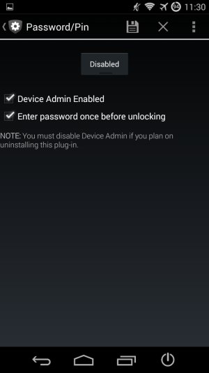

This time, we leave the button Disabled. This is what will kill the PIN requirement.
My own personal thing here: I activated the option for entering the PIN once after the connection to WiFi is complete. This is like a last ditch thing in case my phone is separated from me away from my house, but won't just unlock if near my router. This option is not required for the set up to work; I am just explaining why i did what I did.
That being said, if you elected not to have an unlock once option enabled, you will not see the '/Wait for unlock'.
You can click back to exit.

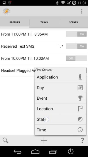

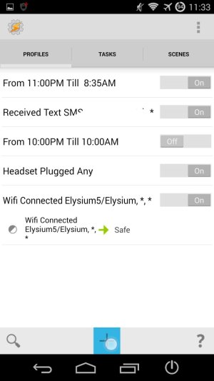

On the Profile screen, click the add icon:

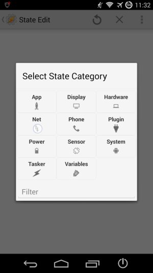

And click the State option.

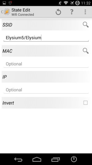

Choose Net,
Then WiFi connected.

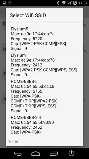

Click the search icon to find your router name:
And select the name when it comes up. It should list in order of strength:
Now, both Elysium, and Elysium5 are mine. I don't want it to disconnect if I change, so i add them both. Adding another name you would have to click the search icon again.
Clicking back will prompt to choose a task. Select Safe.
Here is the finished profile.

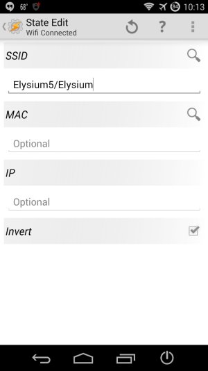

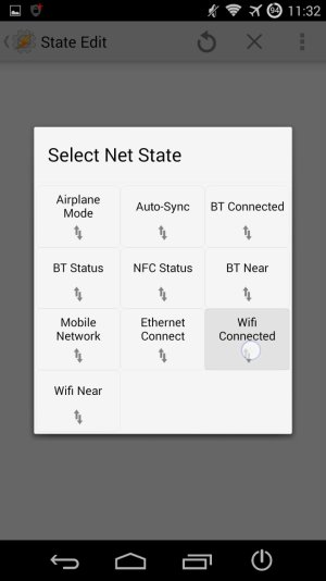

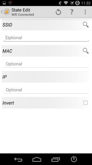

What does work for me is setting up a new profile to enable everything when disconnected. Starting again, we click the add icon, with State:
Choose Net,
And you guessed it....WiFi connected:
Yep..again, select your routers. But, here is the difference. At the bottom, select the invert option:
What this does is tells Tasker that upon disconnection from WiFi, it is to ask for your PIN to enter your phone.

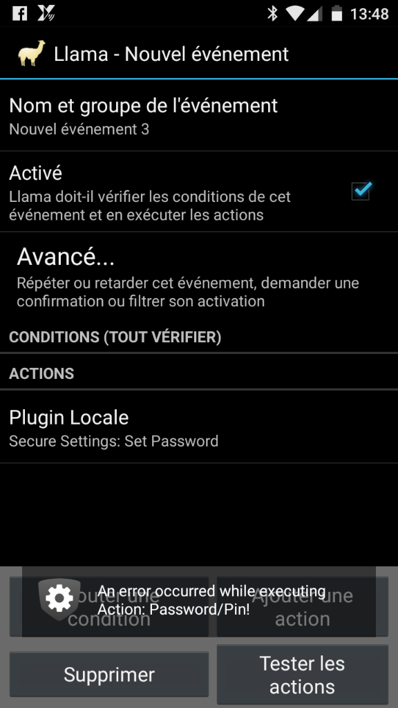

Hi, when I set password, I have this message...
Any idea ? (android 7)
Same error for me also.
CM13 on Oneplus 3
Before I had an older Cyanogenmod where it worked...so something broke it at some point..
Hope it gets fixed.
