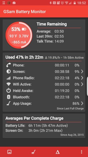

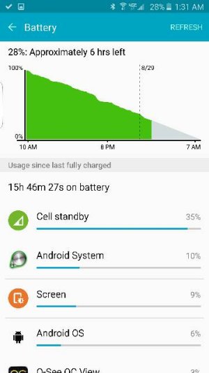

Cell Standby way to high expecially for being on the home wifi 90% of the time.

This really seems excessive, like crazy loss of battery. Is there anyone here who has an educated opinion about this?

It looks like you too have VZW. I have this same issue on my regular VZW S6. My Sprint Edge+ doesn't have the cell standby drain.
As far as solutions go, there are quite a few of them that have been discussed across a few sites. Some people say a factory reset does the trick and others have no luck with it. Then there's the disabling Advanced Calling option, which I've tried, but doesn't work for me. Some say clearing the cache within stock recovery helps, but it hasn't worked for me. Google it for the S6 and you'll see a lot of different posts regarding the issue. Maybe one of them works for you.
Ok, so finally someone who knows what I'm going through. But unfortunately, I've done all of these. I cannot seem to get back into the recovery screen, however. I hold the key combination and either it boots into ODIN and begins to 'DOWNLOAD FIRMWARE', and nothing happens, or it boots into an abbreviated Recovery screen where there is no option to Wipe Cache. I did a factory reset but that just happened by itself on one my keypress combinations to get into wipe cache. I held volume, home, power, like I'd done before when it booted into recovery screen w/o wipe cache, when suddenly the little Android popped up saying resetting device. Very strange and frustrating.
Haaaalp.
I've actually found nothing on the web concerning this. Which is odd because I can't be the only person with this issue. Any help? Someone? Anyone?
It shows you have apps taking 86% of that drain. What apps are running? Your issue seems pretty clear cut - find the Apps draining your battery and you'll be good to go

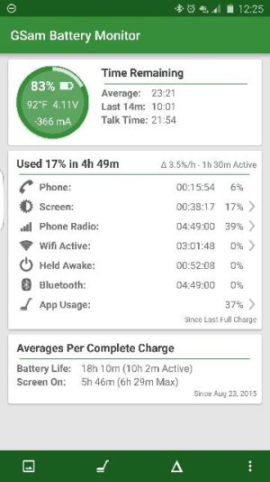

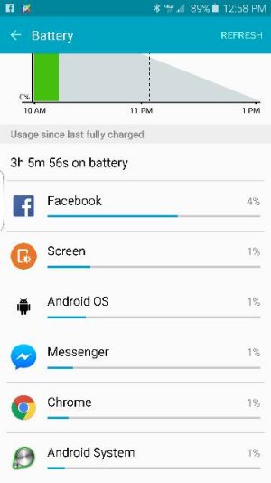

Okay about 9 days in and the newness is wearing off (as meaning constantly doing something with the phone) nice numbers with an average of 5-6 hours of screen on time daily on AT&T.

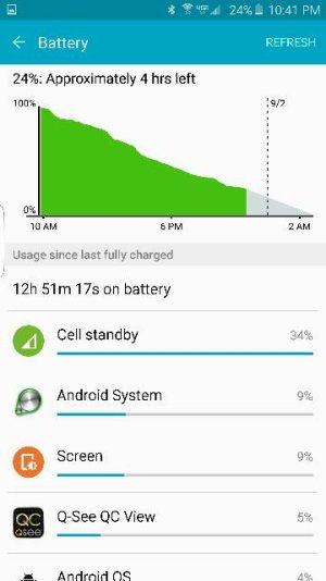

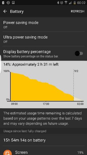

What is this with the Cell Standby using so much battery when all day I was on my home wifi. Reading on the Note 5 it's having the same problem some are speculating it's a wifi bug due to Cell Standby barely showing up when with very little wifi usage. My Cell Standby was 34% today. Think I'll try not using wifi at all tomorrow.

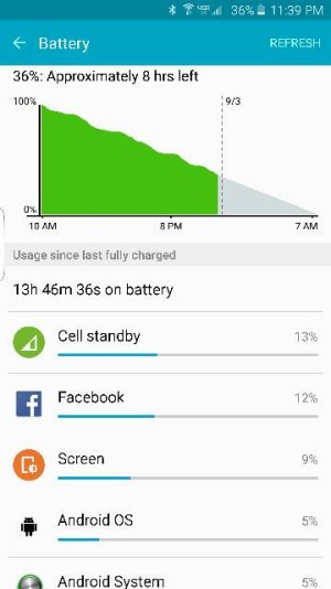

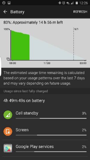

12 days in and getting better battery life every day! On AT&T, GS6E+ 64gb platinum gold model.

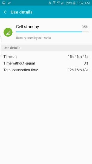

Turned my wifi back on at 4:08 pm to see how long it would take for Cell Standby to show back up In Battery info well it's 6:08 exactly 2 hours.
Finally after 5 hours and having my Wifi at home on Cell Standby caught up and now using more battery then anything else. Surely this is a bug that can be fixed by Samsung or Verizon.
