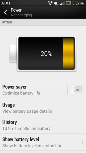

Does anyone with knowledge of 4.3 (probably relating to other devices as well, but HTC One in particular) know why there is a drastic increase in Battery Drain caused by or related to the "System Idle" process?
Sent from my HTC One using AC Forums mobile app
