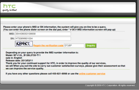

It doesn't seem like you have a genuine HTC One, but rather a Chinese replica. The 'lying dead droid with a red triangle above him' doesn't actually exist on HTC devices, as far as I am aware. Can you take pictures of the box and the device? And post your IMEI and S/N? I am almost certain you were given a replica.

There was a sticker in inside the box with these codes:
IMEI: 354436053108658
S/N: HT338W901034
P/N: 99HTT151-00
Box, beatsaudio earphones, and the phone itself everything looks perfectly real tho.
About the chinese part this guy claimed he needed it for his study thats why he had added a custom ROM with chinese on it.
But then again, you might be very right if that icon did not exist on HTC's I am probably screwed.
