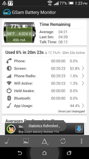

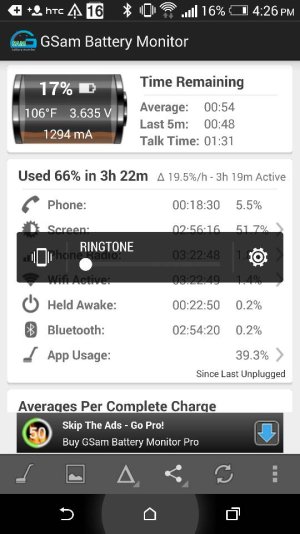

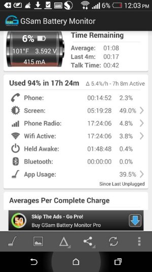

Notice the large delta of 8.9%/hr? Look at what percentage of your uptime is screen time. Your screen use is way high.
Its a tale of two screen shots. Low battery loss when you're not on your screen. High battery loss when you're on your screen..you are draining your battery , what you're calling prematurely, from high screen usage. End of story.

Where is the high screen usage

I didnot use the screeb alot I charge it and then after 8 hrs of sleeping the battery was 68 percent without wifi

In the interest of bringing this thread to a close, lets do one final test so you understand what we are trying to show you.
1. Fully charge your phone (your phone is fully charged when your led is green. Do not proceed until then.)
2. Do NOT use your phone for 8 hours. This means *NO SCREEN* use or other usage like phone calls. I realize this may very difficult for you but draw on your inner strength!
3. After 8 hours post your gsam results, for the main page and the App Usage page. Also indicate if you had a WiFi connection or not during that time.

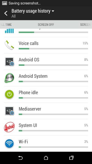

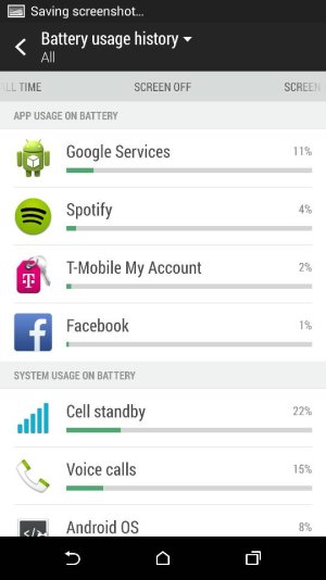

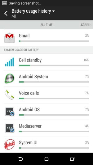

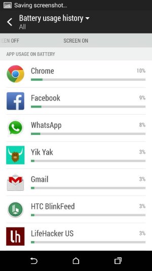

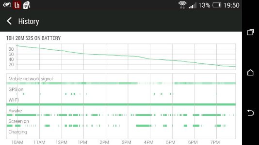

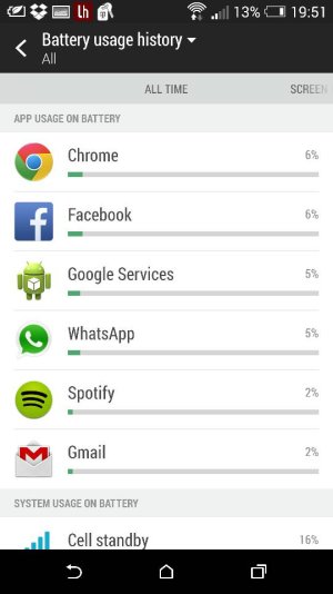

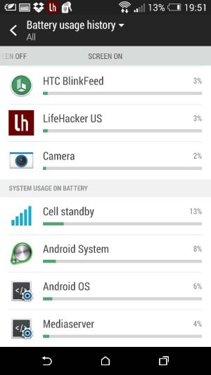

Hey guys. These stats are after updating to the latest update from T-Mobile. Not that it was any better before the update. Just thought I'd give T-Mobile some time. But that ain't happening no more. Battery drains like crazy. If I start with a 100% in the morning around 10 am the battery is almost dead by evening around 7 pm. Surely there is something wrong. Just can't understand which app is draining the battery. I'm not really feeling the pinch right now because I can always charge it in college. But it still ain't a good thing. What do you guys suggest?

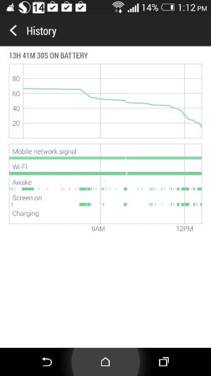

Will First I want thank you all guys for replay I took the phone to HTC garranty and told them about my problem after 1 day of check they called last in night and it was not phone problem it was charger problem probably 1amp is not enough for the battery to work good so they gave me 2 amp charger I charged the phone full last in night and then I use it and here is the result ......its working good now thank you guys again for help
In a couple of your screen shots Chrome has high usage. When using Chrome what type of things are you viewing in it? Are you watching videos, or listening to music over the Chrome browser - if so that could account for quick battery drain. Include a screen shot of the main screen of GSam battery monitor where it lists how much of your battery is being consumed by the screen, apps, screen on time, etc. If you spend a large amount of your time with your screen on during that nine hour window (like people have been telling Mm8) then its not a surprise your battery would be depleted by within a day.
Some M7 users reported quicker battery drain after one of their updates, and a lot of them solved it by clearing their system cache. You could try the same thing, and see if improves your battery life as well.
