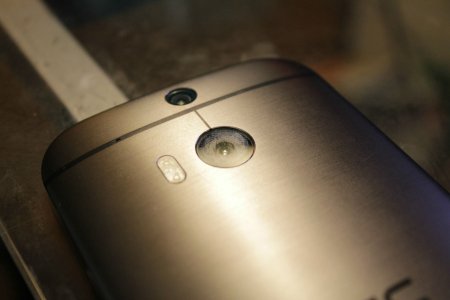

I made an account just to thank sillyphillie and Skyway for recommending trying to scratch off the coating, you saved me and alot of other people money.
My m8 lense was scratching horribly, and I didn't understand why. I baby the living hell out of this phone. It is in a commuter case I make sure that it is the only thing in my right pocket (no keys, no change, ect), but it was getting these horrible scratches. I was trying to take a picture of a room in my house today and it was so blurry (its below) that the light from a window was just hazing the whole photo.
So I gave up and started searching and I found this thread, and read all of it. I didn't see any before and after pictures to confirm the scratching off the film theory, so I am making them. IT WORKS To all the people paying, don't. All I did was take my fingernail and scratch it off. I didn't have time to do all of it, I just did the area where the lense actually uses, but if I had time I'd do the rest. Here are the before and after pics.
The lense, scratched to all hell for no reason.
after scratching the coating off. You can see the color of the lense has actually changed.
and a picture of the room after the fix.

Wow... what a difference! Thanks for sharing.

You're welcome! I'm glad I could help and everything worked for you! I would recommend getting a camera lens protector (just like a screen protector except it covers your camera lens) to help protect it.

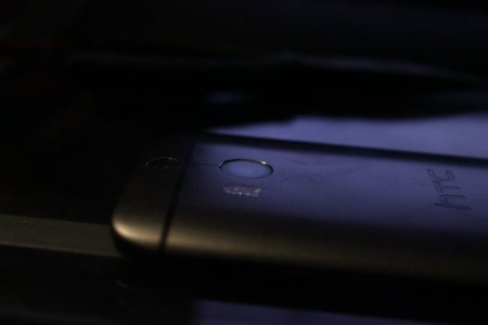

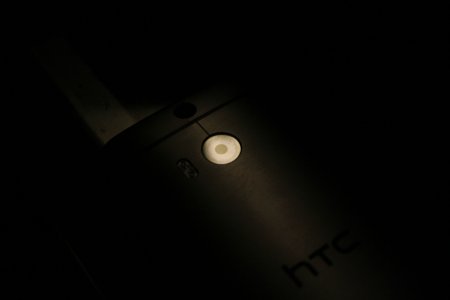

I have figured out what causes the lense hazing. The phone getting hot, weakens the protective coating causing it to be easily scratched or haze. I was looking through my gallery and saw that friday, my phone was taking perfectly clear photos, I didn't notice the hazing till Saturday night, the only thing I did Saturday was go on a long car ride. I was playing alot of games and listening to music for a couple hours straight and my phone got really hot, I didnt think anything of it, since i had owned a m7 before the m8, which got really hot too.
So to test my theory, i took a heat gun and heated the front facing camera, which at the time was perfectly clear. Using a infrared thermometer, i measured the lens to be 115-120F. At which point the hazing started to happen. Proving my theory.
I have another theory, part of the reason why almost only people with cases are getting this, is because the case provides insulation, not allowing the phone to properly cool. Idk how to prove that one though.
TLDR: Heat causes the coating on the lens to weaken/haze
