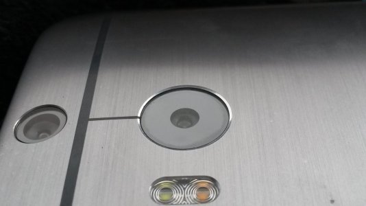

I have had my M8 for around 3 or 4 weeks now and noticed as many light scratches on my lens same story as many others.
Just thought I would share my experience in this, having followed the advise on this thread and from this guy PSA, _if_your_htc_one_m8_has_a_scratched_camera I used a credit card type thing to rub off the coating then wiped the lens with a screen cleaning cloth (the yellow ones that come with screen protectors).
I was under the impression that it was a film similar to a screen protector but this is not the case at all.. It's more like a coating that's been applied to the lens and it requires you to rub it off and not peel. All in all it took around 15 - 20 minutes to sort.

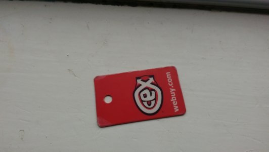

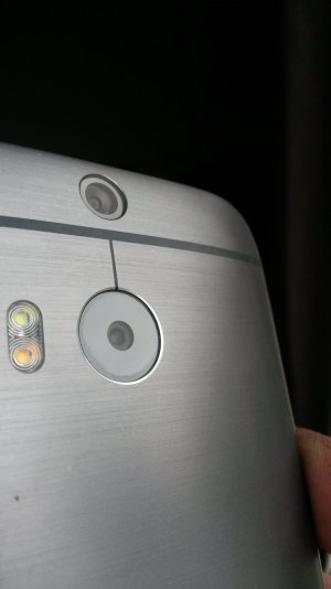

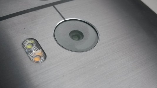

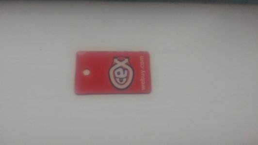

Any way here are my pictures.
The photos of the M8 were taken on my wife's s4 mini.
I started around the edge first as I was a little apprehensive. You can see where it is scratched and where I rubbed off the coating.
Did all around the edge.
Then the centre
Then a couple of before and after pics
Before (this is what I used to remove the layer).
After.
Before. It's like cataracts i imagine.
After.
The results are pretty good and I'm happy again. I'm going to make a lens cover from a screen cover and be keeping my phone in a sock from now on though!
