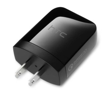

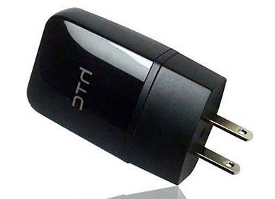

I received my M8 in late December 2014. The charger on it died and I just received this one:

The one that broke is this one:HTC Charger 2.jpg
I think T-Mobile ripped me off by sending an older 1.5A model instead of the 2.0. Am I correct?

As far as I know, the M8 only ever came out with a standard 1.5A charger, not a QC2.0. The CQ2.0 was an optional purchase.
It was not a "standard" 1.5amp charger but a quick-charge 1.0 one. But your correct saying that it wasn't 2.0.
Not true. Qualcomm says it's 40% faster than the ones without quick-charge 1.0, you can check it on their site

The one that broke is this one:View attachment 203547
Thanks.
Read the fine print on the charger. It will say what the amperage is. It's probably a 1.5A. If it doesn't say Qualcomm 2.0 on it, it isn't. The current standard is QC 2.0 The new phones will work with QC 3.0 when it comes out this year. QC is a LOT faster than the old stock 1.5A charger.....
