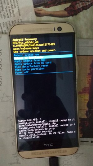

this is what i see at the top of my phone , can you please help me out with this..

This is the best and onlyvone way it is working normally. I have same issue (Updating to 6 stuck in 83% and recovery mode only). Just following this method 100% success. I done. Just you want to know which ROM you should download with your device. Thank you so much you.
Re: HTC ONE M8 Stuck in "Android Recovery" after failed update
First, download and install the ROM according to your device. htc.com/us/support/rom-downloads.html
Then download and install HTC sync manager. htc.com/us/software/htc-sync-manager/ This will help pair your device with the PC.
Connect your HTC device to PC via USB cable. Turn on the phone and go to bootloader.
Open HTC sync manager and dont do anything. Just leave it there.
Then open the RUU app and proceed with updating/installing the ROMS.
This is the only way can success. I done and 100% okay. Just follow method what you mentioned. Thnak you for sharing this. Again it is working with android 6.
Just following (hOao3) posts. I try and 100% successful and now work on android 6. This is the best method. Thank you for posting.

Thanks my phone finally worked. I followed the steps mentioned above.To remind you
1- Download HTC sync manager and open it
2- download HTC One m8 Rom(ruu) from HTC support
3- make sure you downloaded your phone specific ruu(mine is unlocked/developer version
4- connect phone to PC and put your phone on rebooting
5-open ruu and follow the instructions and readme is very helpful.
