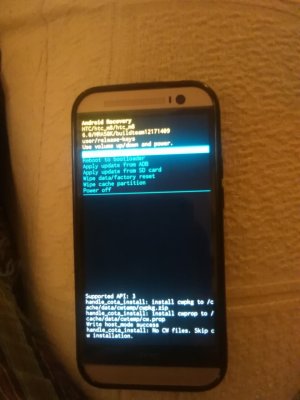

My htc one m8 is stuck in recovery mode?
after a new software installation and I have tried rebooting it and it come back to the same page, any idea how to fix this?
My htc one m8 is stuck in reboot system now?
Yes I did
My phone is stuck on the rebbot system and it keeps going to the same screen everytime I reboot. This is the page its stuck on.
Re: My htc one m8 is stuck in reboot system now?
Thanks for registering and welcome as a new member! Is it similar to the problem discussed in this other thread? Have you already tried those steps?
http://forums.androidcentral.com/showthread.php?t=628652
I'll contact the moderators and see if they can move your thread to the M8 forum. Several users are reporting different problems after the update.
Can you wipe the cache partition from there? Check that link for the right steps.
