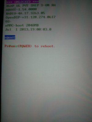

hmmm think my OS got wiped out it shows OS- ... oh and any guide to RUU it? Maybe i was doing it wrong... Btw let me show you a screenshot of what happen when i put in the firmware file and rename it to PO68IMG.ZIP.

why did you rename the firmware to PO68IMG.ZIP. is that the model number? and where did you get it?. Yes you can RUU by putting it on your sdcard and flash through hboot. we need to find the exact model # to name it to. do you know the CID by chance?
Hmm... cause when i put in my SD card it always shows checking for PO68IMG.zip, thats why i try renaming it into that file. Btw, is there anyway to check the CID? model number i will try to find out give me a min...
Nope did not add .zip the file name including extension is po68img.zip. oh... my bootloader is unclocked :(. Nope the only place i can get into is fastboot. when i enter recovery, it just goes into an infinite bootloop.
