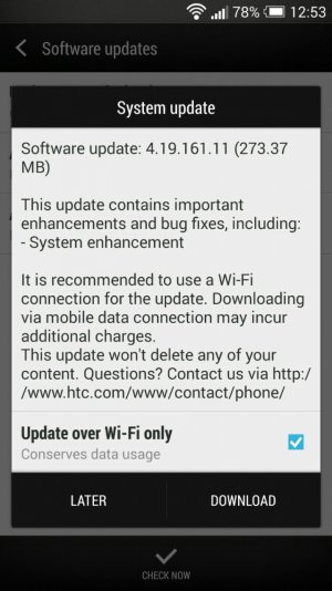

Weepatc that's strange as I have an unlocked uk model and have nothing yet.
That is strange. Vodafone UK right on the ball here. Guess you'll get the update shortly.
Issues solved with todays ota in europe , expect another ota soon with sense 6

I bought HTC One on Three in the UK a few weeks ago. Downloaded the 4.4.2 update as it was setting up, found the battery was dreadful (would lose 1% of battery every couple of mins while the phone was switched on, whether making calls, texting, browsing), took phone back after a couple of days and Three gave me a brand new phone. HTC UK had pulled the Kitkat update by then, so have been running 4.3 last 2-3 weeks, and battery has been fine!
Today, got the message a software update to 4.4.2 is available once more. I'm obviously reluctant to install it given what happened last time... the update is to 4.20.771.17 and takes up 358mbs, so this is different to the new software announced today, which is version 4.19.401.11 and 205mbs, but I think is a fix to Kitkat if you have it installed already, which I don't, so 4.20.771.17 could be the new improved version of Kitkat for HTC One in the UK (think it was 4.19.401.8 that screwed my phone first time round) - but then then an earlier poster had a different software version from Vodafone UK too.... so I am a bit confused, and nothing comes up on Google search for 4.20.771.17. What do the wise people of Android Central think?! :)
