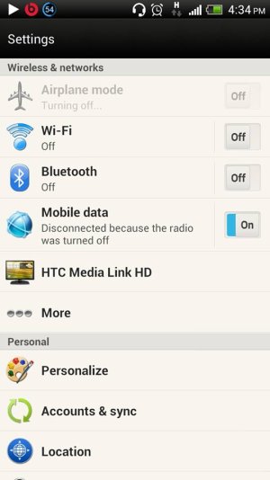

hello all,
when i'm on mobile data sometimes currently i found my phone get overheated and then the airplane mode turns on automatically and mobile data says that's turned off because of radio signal, i attached the photo of the problem, and to restore the connection i must turn off the phone for 15 min. or so.
is there any solution for this problem?1374278_10202063218211543_2087186687_n.jpg
Welcome to Android Central! If the phone is starting to overheat, it might be a safety mechanism for the phone to turn off the cell radio. Phones often have a Cooldown mode that turns off functions like cell radio temporarily. Overheating can occur sometimes if cell signal is poor, because the radio starts to work overtime to search for signal. Was it weak at the time?
Another possibility is some app misbehaving, and perhaps excessively accessing the web. Try installing GSam Battery Monitor to get a breakdown on what's using battery and CPU.
