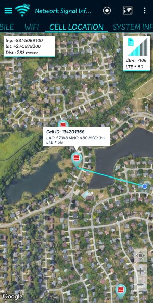

There is indeed a 5G extender. As I mentioned in my earlier post, two of my neighbors have 5G extenders. I know, because my phone is constantly connected to one of them while I'm at home.
Interesting. I wonder if that is a network extender, which generates its own signal, or the other approach where someone puts up an external antenna, and then amplifies the signal originating in an external cell tower. Will look into this.

So I've done some searching, and there is no Verizon 5G femto-cell type of network extender. These are 4G only. There are 5G devices which use an external antenna to pick up a 5G signal from a local cell tower, and then amplifies this within the home (and adjacent area). As best I can determine, that is probably what @leerandall is connecting to.
There are devices called "5G Extenders" but these are actually WiFi extender devices, for homes with a solid 5G signal, to provide WiFi access to the 5G signal.
Lastly, there is a similar thread here. The experiences there seem to support my working theory on what's going on here:
When I'm at home, there is enough of a 5G signal, even though it's weak, that the phone's OS prioritizes connecting to a weaker 5G signal over a stronger 4G signal, and so it usually doesn't connect to the 4G network extender. Randomly the 5G signal in my home drops low enough that it then connects to the 4G network extender. But when the 5G signal randomly increases in strength, because it prefers it, it then connects to 5G, dropping the network extender connection.
If that is correct, then I would further suspect that the dropped calls I experience at times might occur when the phone switches between the local 5G cell signal and the 4G network signal, as the 5G signal fluctuates in strength. And perhaps the missed calls might also occur because of the switching that randomly occurs.
I just went to this guy's house (he wasn't home), and there is no external antenna on or near his house. I suppose he may have put the antenna in his attic, though.
I think that's what some do. If somehow he does have a 5G network extender, I'd love to learn what model it is, where he got it, etc., as I can't find any reference to it (other than one site showing it as a future product, and which wasn't actually Verizon branded).
