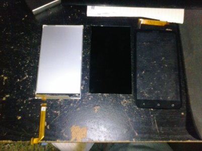

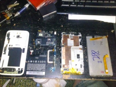

While I was trying to fix my phone again for the first time in a few days, I finally pulled it apart and figured out the issue: the lower ribbon cable for the screen had been torn somehow at some point ._. I don't know if that'd cause it to be stuck in a boot loop, but it would explain why the screen wasn't lighting/showing anything. I had noticed the day it "died" temporarily that the outer screen/plastic was pulling away from the inner board for some reason, I guess the glue had worn off over the years?
