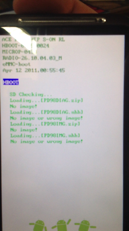

I was just give an HTC Inspire as a gift with the condition that I could get it working - the previous owner could not. I'm stumped as well. I do not know if this phone has previously been rooted or not.
Anyways, here's a picture of where I'm at. This message flashes for half a second before going back the fastboot, recover, factory reset, etc. screen. I can NOT move use the volume buttons to change my selection factory reset, and pressing the power button does not do anything either. I have to take the battery out to reset it all.
View image: photo
Although I'm sure they exist, I can not find these files to put back onto the SD card so it can re-load android(if thats what I need to do). I don't care if everything is erased or what happens, as long as I get to back to any stock version of android for this phone. I'm very new to android so links to specific programs/files I may need would be a huge help as well.

After playing with the phone for a few hours I've been able to get the volume buttons to change it's selection a few times, but it only lets me change settings very randomly. In the times that it has allowed me to change settings, the Recover setting ends in red triangle and exclamation point. The factory reset boots straight back to HBOOT. Fastboot, simlock, and image crc didn't seem to do anything.
