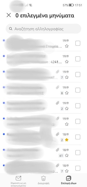

Ok, here is a screenshot (the language is Greek btw)
When longpressing a message in the Trash Bin, the sub-menu has 3 choices (from left to right):
Mark as Read/Unread, Delete , Select AllScreenshot_20240925_175105_com.huawei.email.jpg
That's pretty strange. I assume that if you mark a trashed email as Unread, it still remains in Trash?
If you haven't already, try opening one email, then tap any menu button you see (i.e., a 3-dot menu button). Any pertinent options there?
The only options when opening a menu on a trash bin email are Mark as Read/Unread, Print or Add to Calendar. The usual stuff are there too (reply, reply to all, forward etc), but nothing else.
I don't know exactly how the stock email app on your phone works (I'm only familiar with the Gmail app), but it's possible that if the trash bin gets totally overloaded, it might not be able to restore any of those emails.
