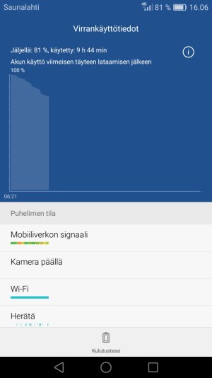

My Huawei P9 phone is now 3 days old and i´m wondering why battery drains so fast, even in stanby. I charged phone full 100% an after few hours there is 70 - 80% power left.(idle) I have a"clever" battery profile in use an there is no any "lot of power" using apps running.
Is this normal stituation or am i middle of troubles?

For the first few charge cycles (100% to when the phone shuts off), the drain may seem a bit high. Also some apps may be updating in the background, which will increase the battery drain. And check the Battery in "Settings" - tap the graph to get to the next page and look at the mobile signal line at the bottom. If it's anything but solid green or white, the phone's transmitter is running at higher power because the signal is weak, and that uses more battery too.
Welcome to Android Central! Seeing some battery stats may be helpful. Charge up to 100%, then let it drain to 20-30% with normal usage, without charging in between. Then show us:
1. The main Settings>Battery screen.
2. The fullscreen battery graph screen (which shows Awake time and Cell Signal Strength).
3. The Screen category (to see total Screen On time).
4. The Cell Standby category, if present (to see Time Without Signal).

Thank you for your help, i.ll think problem is solved now. Factory reset performed and maybe themes causes abnormal power leak.
