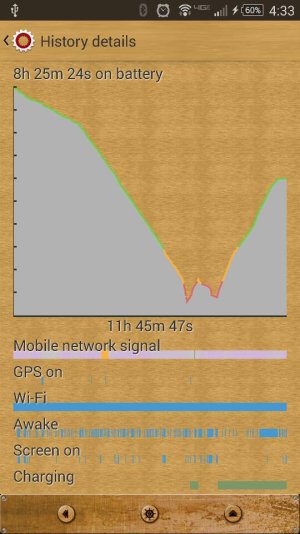

Went to work this morning and woke up around 5:30am. Used it for minimal time for just texting and such. I had Bluetooth on too because of my moto360. Ive recharged it fully from dead before with the original cable and power brick, uninstalled apps from right around when this started becoming an issue to the present, and it went to 6% in just 6 hours.
The small spike upward was my charging it on the way home from work. I absolutely should not be having this problem after only a little over a month of owning it. I contacted xperia support and they were no help.
From that battery graph, there is an app(s) (rogue) or otherwise that is sucking down your battery. If you know of GSam battery monitor, download it from the play store and it will tell you of the culprit that's keeping your phone active. Also a weak mobile signal will deplete your power. Notice you're on WiFi almost all the time.

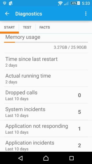

I'm having the same issue with my sony xperia z3v. I've enjoyed fantatstic battery life since I bought it back in September but I noticed on June 13th (Saturday) that I was experiencing a 10% battery life loss every hour if my phone was idle. I had not installed any new apps in a couple of months and my app history showed that recent updates had occrered to Google app and Google play services. Sure enough, when I check the battery status Google Play services is eating up over 40 % (more thatn even the display) and sometimes spikes to 70% (see attached screenshot). Since this is a core service I do not have the option of uninstalling updates.
I chatted with a sony rep and they want me to factory reset the phone so I'm going to have to back up everything ad try that. Does anybody have any otehr ideas?

The graph in Post #10 says that you had virtually no mobile signal all day and only a minimal signal for small periods of time. That runs the transmitters at full power, generating lots of heat and eating lots of battery. I think your problem, unless the antenna is disconnected or the receivers are bad, is the wrong carrier - they seem to have no signal where you are.
