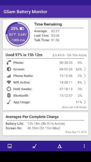

I have three mail apps syncing, all antennas are on all of the time and I'm getting nearly 5 hours screen on time and about 12 hours usage on a daily basis! Now, the battery did have to get through some cycles before I experienced the full longevity of this baby.
