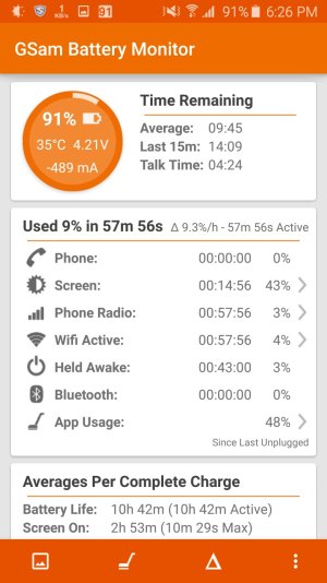

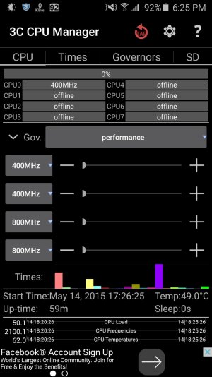

I tried various methods. I have some screenshots you can take a look at. You see that it won't go to sleep, not for a second and the CPU is really hot.

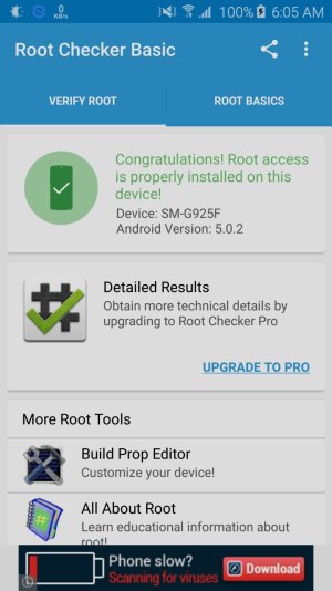

How was it rooted, original way or latest PingPong root? I'm asking because there was a huge issue with Wake Locks and Deep Sleep with the original method and it seem like it was normal for rooted S6/edge to not going to deep sleep. I think there was a work around but can't tell you for sure as I didn't pay too much attention as I don't have any plans to root mine.

According to the link you posted it is definitely the original root, the new one is called PingPong Root, check it here.
You can see a couple of threads over XDA mentioning the issue with the wakelocks and no deep sleep after root, here it's one, No deep-sleep? | Samsung Galaxy S6 Edge | XDA Forums, like I mentioned above I didn't pay attention to it but I think I read at one of those threads that there was a work around, see if you can find about it. Also, now that you mention that maybe doing a re-root, well, try that with the new PingPong root, but at least go to recovery mode and do a Wipe cache Partition before and after you do the re-root, to see if it helps.

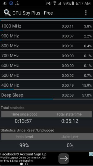

Hello there! Thanks a lot for the reply, and I think your advice did the job! (still testing tho) :)
I just wanna give a little update info. I did try your method of unrooting and rerooting. It may be the problem; I am not entirely sure. I updated my software to the latest with Smart Switch, headed to the devs' forum and rooted with no problem.
I think I am seeing something here. A development; I can now see that it is going to deep sleep mode. I hope this is fixed. I got up real early today just to see this. I am sleeping again; I hope I see my battery being preserved like it is supposed to when I wake up...
P.S Device is a little warm... What's wrong with it, I am not sure. Background apps...?
Re: I really need urgent help: S6 Edge won't go to sleep, draining battery overnight!
Update 2
I tried sleeping, but can't; ended up back on my PC after 15 minutes just to check my phone out.
It's not warm like it is used to before. It is now conserving much energy, and going into deep sleep! :)
