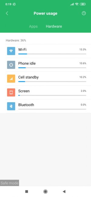

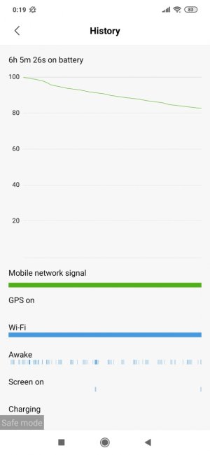

So here's the battery usage of the past 6 hours ( after it was charged to 100%) of the phone just sitting there on idle , doing nothing , with no background apps etc , booted on safemode.
Just got the phone back from service , there's nothing wrong with the battery or the phone overall , they even had the phone set to their wi-fi and it drained 55% in about 48 hours. So the thing is , when i turn it on to my own wi-fi the battery drains like crazy , the moment i turn off my wi-fi it stops . It's only on my own wi-fi that the battery goes haywire .
