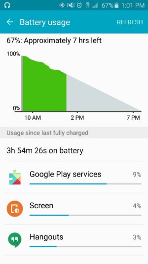

Interesting. Well maybe that guy's a phony. Either way, your numbers aren't terrible. I'd personally be a little disappointed with them myself, but they aren't as terrible as most are saying. 4+ hours of SOT for a full day of usage. And your chart looks pretty normal. One question though, what is the difference between Android OS and Google Play services? I don't have Google Play services listed on my Galaxy 3.

I think he misunderstood what was asking, this is the chart, and I am sure s6 has it. (I borrowed this pic from Almeuit's post in another thread on this board)

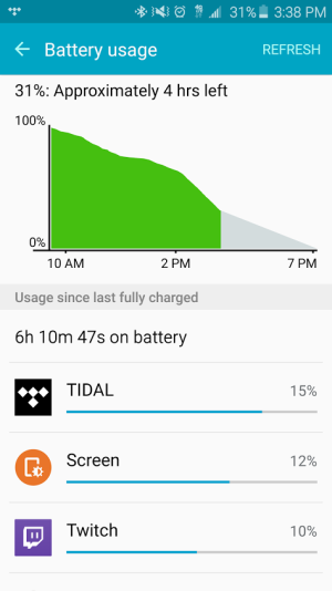

Today so far.
Auto Brightness... Until 2PM - 3:30 PM ... I then had it on 80%+ streaming HD video from various places and also web browsing
Tidal (music streaming) for almost 2 hours
Twitch.TV for 1 hr 30 min
All services / syncs on except... ANT+ disabled and WiFi Calling is shut "off" (along w/ the WiFi radio)
30 min worth of VoLTE phone calls
~15 txt messages // 2 MMS pictures
All audio going over BT
All data being streamed on LTE

Is it good or bad , sot looks bad
Well see to me .. People harp on SoT too much. They focus so hard on it .. that if one thing is bad in a SoT shot ... The battery is bad... but you can have your phone do a lot of things with the screen off, which uses battery, and causes drain so your SoT won't be as high. Such as Tidal uses a lot of data for music streaming (~1.5 GB right now w/ these 2 hours of music) so that causes the radio to work more than normal.
Did you take note of what your battery was before you started streaming music and after? Or were you doing things with the phone in between that time making it hard to decipher? I personally don't stream music through my phone very often so I don't know how much battery it uses.
Edit: Based on the fact that TIDAL used 15% of his battery usage so far and he was at 31%, it looks like TIDAL used 10% battery total. So without that, you'd be roughly at 41% with 2 hours SOT
