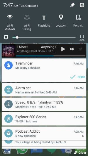

I tried the same thing at home, while on my network and used your exact words. I forgot about it until just now and it never came up as a reminder. Yes it did have my address for my work address and I've been on my network all day, except when I pulled into the underground parking at work and at lunch. Even downloaded a new Kindle book on my network. I've also been receiving notifications. It does show up on my cards list and there's a button for "remind in 10 minutes". But there was no notification alert.
