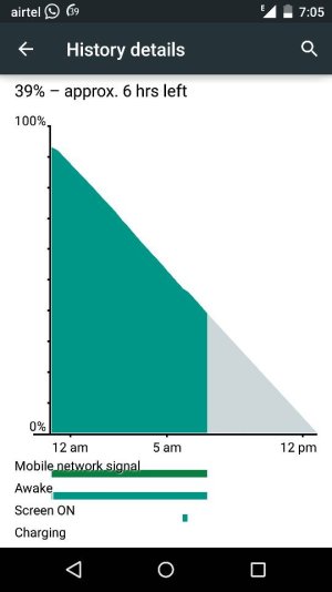

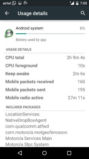

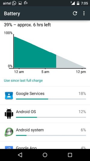

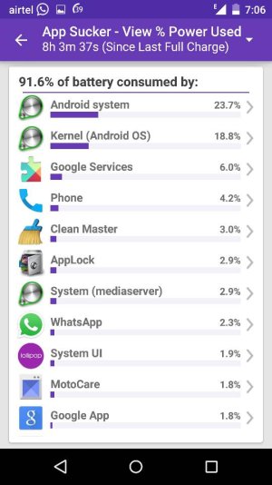

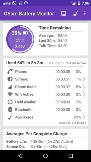

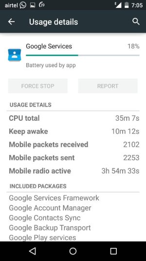

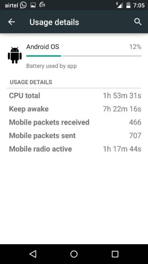

I don't have any idea what's keeping my moto x insanely awake. I rebooted many a times. Restated by pressing power and volume up button. Nothing worked. I don't want to factory reset. Do you guys have any solution? The problem started 2days ago. And yes in these 2 days I didn't installed any new apps.
Android OS, Google service and Android system eats away all the battery. In idle mode it eat up the juice at 6.7% per hr. It dropped down from 93% to 37% overnight in idle mode... very frustrating..
And what is this "Mobile Radio"?

In your screen shot there is a logo next to airtel. Is this a running app? If so it may be what is draining your battery. I also noticed the E next to your signal strength. This means you are on Edge (AKA 2G). If the phone is set to LTE (AKA 4G) and you do not get that service in your area then the radio will continuously look for 3G and 4G signals. This may be what is showing up as Mobile Radio in your screen shot.
You can change this by going to Settings>More>Cellular Networks>Preferred Network Type and choose 2G.
Hopefully this helps you out.

If you go into the battery settings it will show you what is using most of the battery. Take a screen shot and post it here. Tap on the graph and a more detailed graph will appear. Take a screen shot of that and also post it here. This will let us see what is affecting your battery and we can try to help you further.

I found the culprit. It was Google+ app. I had my phone in my pocket and started to feel it heating up. I checked GSam battery monitor app and saw Google+ was off the charts hogging power. I disabled the app and wiped cache and now it's night and day better. My battery life is better than ever now. Google+ was probably draining battery all along. I'm happy it's able to be disabled. I don't think I can uninstall completely. Hope this helps others.
