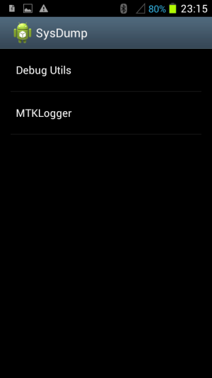

ALSO: I tried to diall *#9900# but I don't get the right hidden menu. The only thing that I get is: Debug Utils and MTKLogger.
Is it possible to get rid of this problem in Samung Galaxy S4 copy?

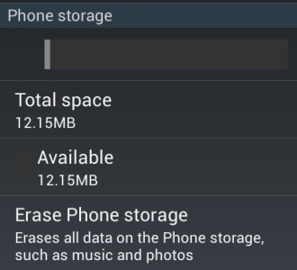

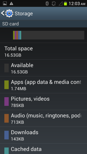

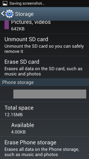

Can you show a screenshot of your storage stats?
Sure. SD card was formated before taking screenshots.
Also, I have installed only three apps (Birthdays and Espier Screen Locker and Orai (weather)) that can't be removed to SD card and other apps are system apps (were uploaded by the creators and can't be removed unless the phone is rooted. MY PHONE IS NOT ROOTED

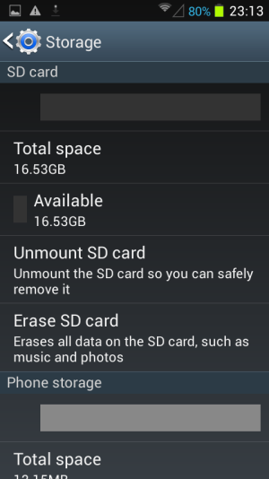

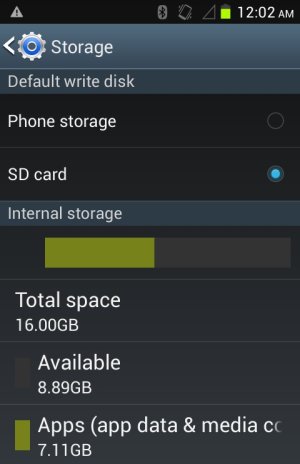

Ok. Let's start over: Reset again, and take a screenshot of your storage stats, please.
Here are the stats after the factory reset:

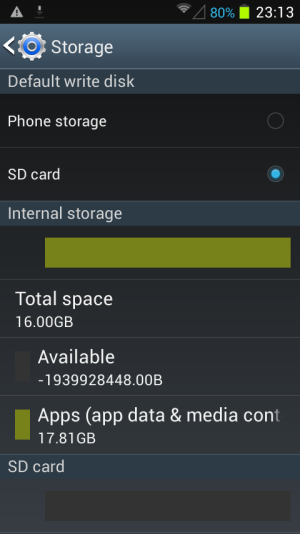

but after those two apps that I mentioned (Pou and Geometry Dash) The Internal Storage ''Available'' numbers go to minus (-) (ex.:-8.80291B)
Ok, the OS is taking up roughly half of your internal storage. The bigger issue is either the apps you are trying to load are poorly reporting their memory to the OS, or they are larger games (I am not inclined to agree with that).

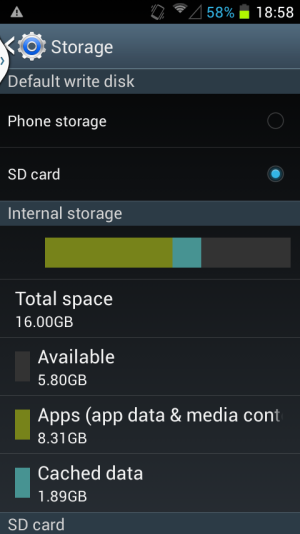

I tried to intall Instagram and here are the changes in Internal Storage:
It changed from 8.89GB to 5.80GB after installing Instagram.
I am wondering if there is an error in reporting storage from the OS. I don't think there is any way Instagram would take up 3 GB...
That means that the phone has a LOT less than 16GB of storage, but it's programmed to say it has 16GB. That's what happens with a lot of those "copies" - they look like the phone they're a copy of, the screens look the same, but what's inside is totally different (and less).
